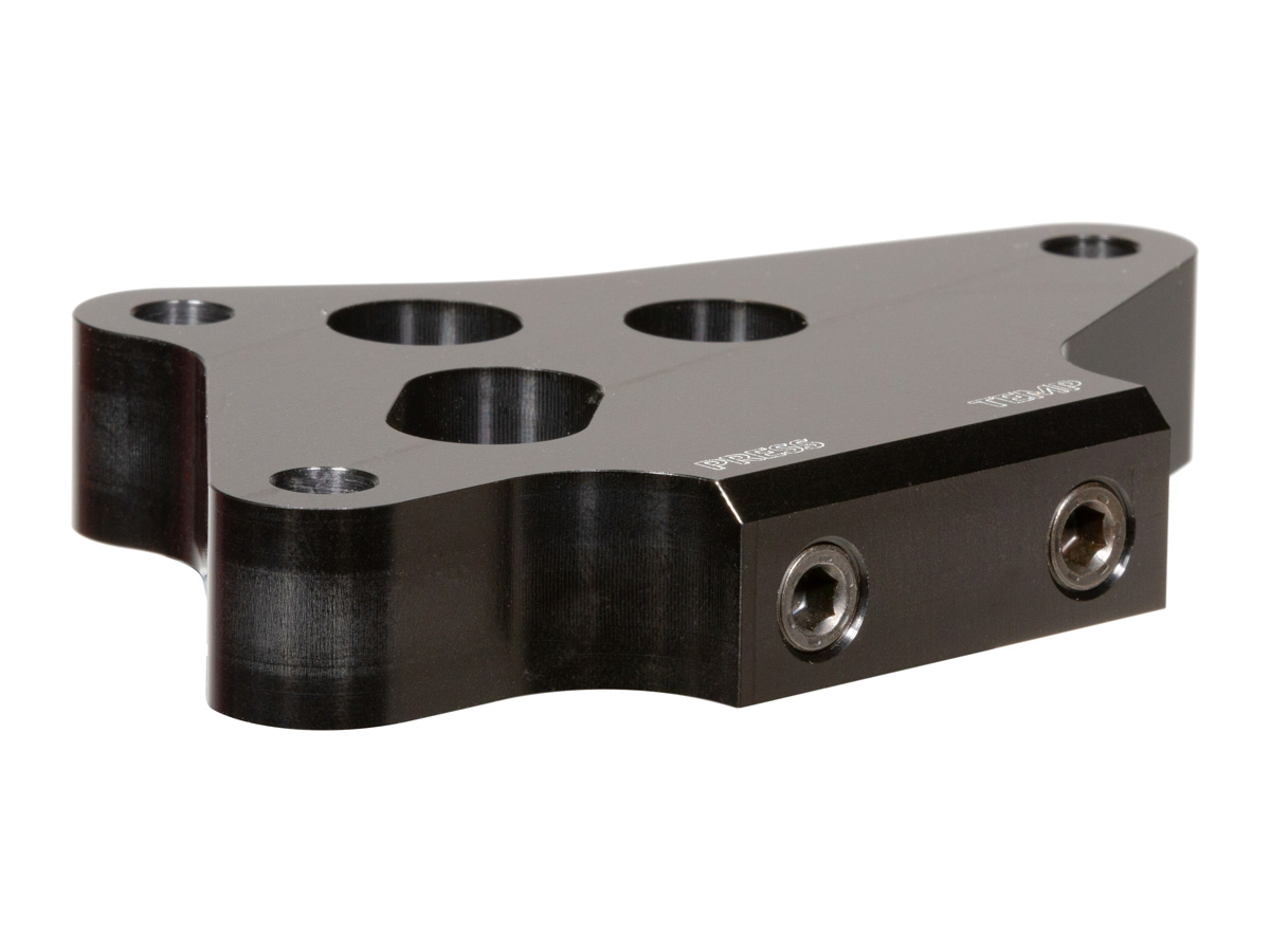

Co to za podstawka z craven?
Re: Immobilizer a OBD2
: 23 cze 2023, 10:25
autor: latar
@Kanosky o takie coś:
gauge_sender_adapters_for_mazda_mx-5_miata_4th_gen_nd_oil_pressure_temp_sender_sandwich_type__9LYB5N7_20895__33068.jpg
gauge_sender_adapters_for_mazda_mx-5_miata_4th_gen_nd_oil_pressure_temp_sender_sandwich_type__9LYB5N7_20895__33068.jpg (112.14 KiB) Przejrzano 1848 razy
https://www.cravenspeed.com/the-tapless ... wich-type/
Montowane pomiędzy blok silnika a podstawę filtra.
