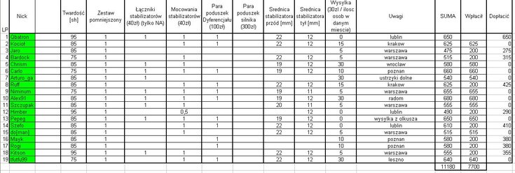

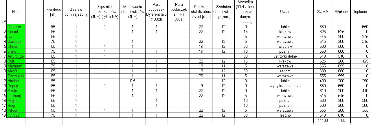

23 mar 2014, 11:33
Stan wplat na dzien 23.03.214

Qbatron
Posty: 2549
27 mar 2014, 17:56
NIE wplacili:
Jaro 275zl
Himber 290zl
Szefo 410zl
Mayk 380zl
RogI 380zl
Kitson 355zl
